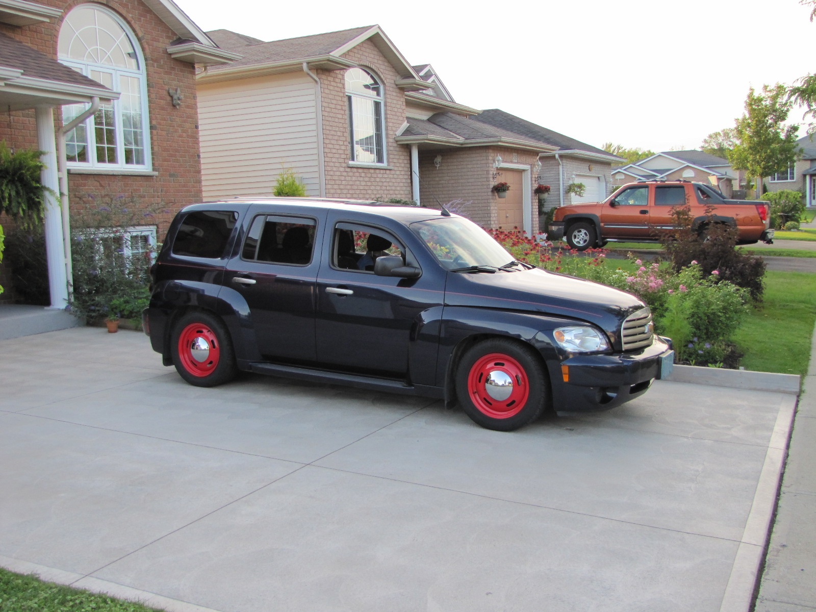

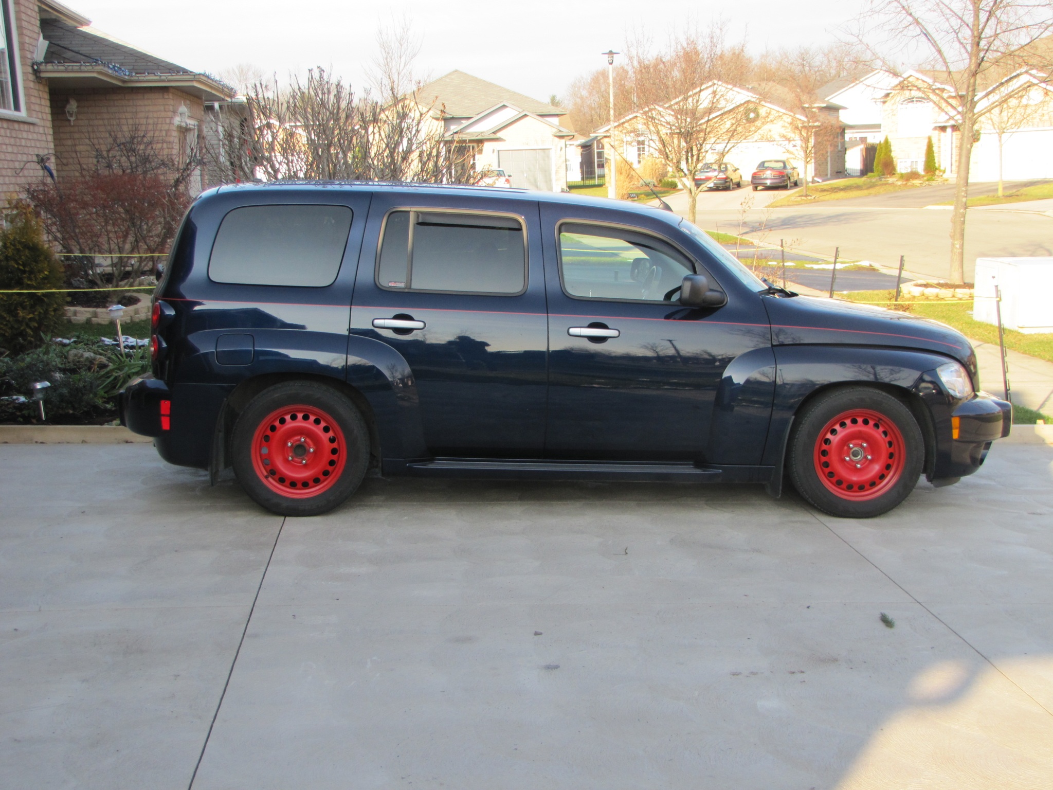

You mean red rims like these? I never did find baby moms that fit, so I bought the WV rally rims and baby moons

Yes, exactly like those wheels. I have Rustoleum Professional in Safety Red that I intend to use. I REALLY like those center caps! What are they, and where can I get them?
