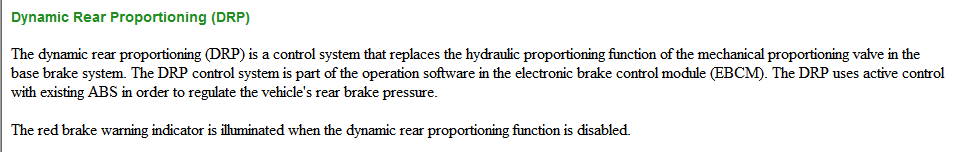

Posts: 26,534
There is no actual proportioning valve with the ABS system, the EBCM handles that. I don't know if you would need to swap out the EBCM from a Cobalt, maybe the same part number.
The MC is split diagonally so, probably no problem there. LF-RR, RF-LR.
Probably just a plug disc brakes in sort of thing.

Posts: 26,534
Not sure about that. Cars without ABS do have a proportioning valve.
