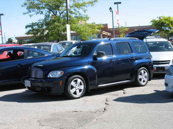

I installed the cobalt SS springs too, first the rear, then the fronts a couple months later.
The front cobalt springs will not lower at all, in fact it might appear to be a bit higher than the rears. Ill see if I can dig up some pics.
They are now my winter suspension, I put on Canuck Motorsport springs for the summer.
EDIT: I think this pic is the full set of cobalt SS springs:
