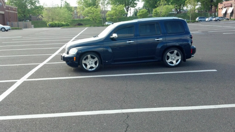

Yes they do.. I Have 2006 Cobalt SS FE5 suspension on my HHR.. Shocks, Struts and springs.
How does it ride? I was looking to go with the SS/TC struts since thats the springs I have. Also as going with the FE3 in the rear cause I've heard the FE5 in the rear is a little harsh
I would not go with the FE3 rear, cause you will have no drop in the rear and 1.2"-1.5" drop upfront and no drop in the rear.
I just had my truck to a trans shop to have my axle seal replace and the guy who worked on my truck asked me if I had modified my suspension and I had said yes. He said he figured cause the ride was much tighter than a typical HHR.. (Their shop truck was an HHR)
