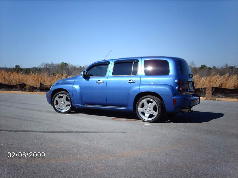

1LT. These are 225/40's. I'm now running a slightly taller 225/45. No drop. The 225/40 were slighly shorter than the stock 215/55R16 and the 225/45's are slighly taller.
If that is stock 1lt suspension...that looks good!
I don't even think I had the sway bar on in this shot. So yes, it's totally stock.
Yeah 18's with stock suspension may be way to go for me because that looks good and I use my hhr for utility and as a loaded to the roof beach buggy with 4-5 people plus a FULL cargo area so lower may not be good
