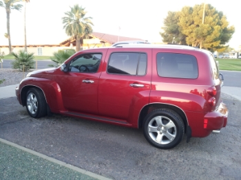

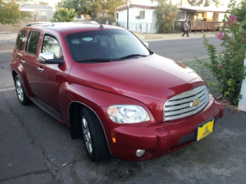

Finally got the HHR i wanted. 2010 gorgeous red mettalic. One of the nicest paint jobs i've ever seen out of Detroit or wherever this was made!! That was my trade for 12 years, body and fender!!

It's much much brighter than it shows!!!! GORGEOUS PAINTJOB!!!!
