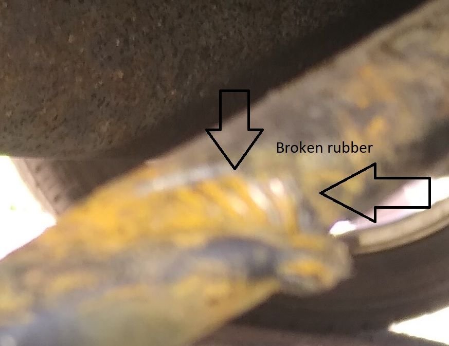

I review again I saw the cable was like cut on the rubber, I took this picture, so maybe one day with the car jack I broke by myself the rubber . so just need to have replace all parking cable or is possible to repair that part only?, thanks in advance

Oldblue Aug 23, 2020 07:42 PM
I’d order new parking brake cables for both sides, I order from RockAuto, very quick delivery to here in Canada and usually much cheaper then Canadian websites

or slap some Flex Seal tape on the cut to seal the water out.
