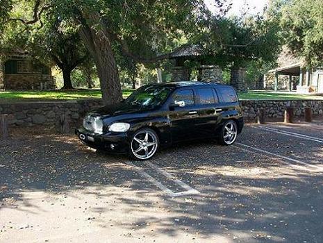

Here's my Buddy UMA's HHR with 225 x 35 x 20's with the Eibach Pro Kit Springs! Since you went with 30's you would probably go with the Eibach Sport Line Springs! Your ride is going to be very low but just don't know how practical!
Good Luck,

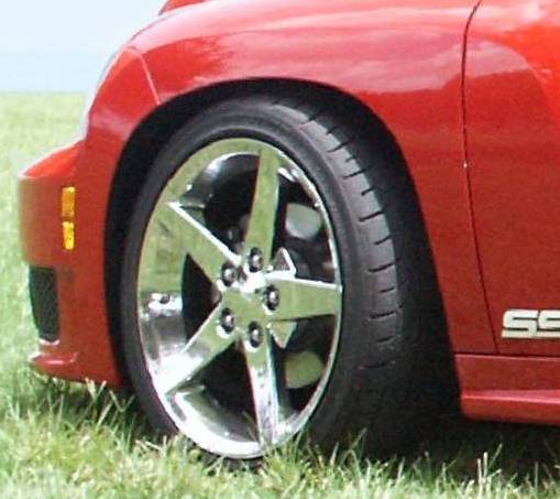

you can installed goldline drop spring with no issues. Your tires are 25.3" O.D.
I have the same identical size O.D. and mine fit perfectly
