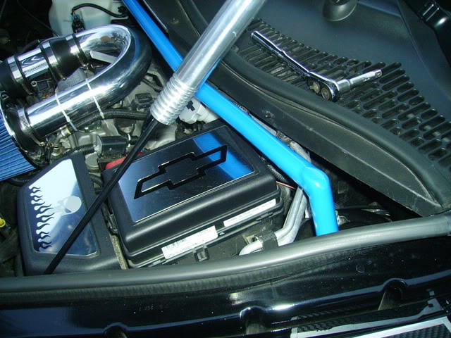

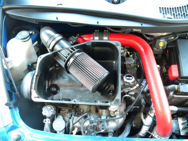

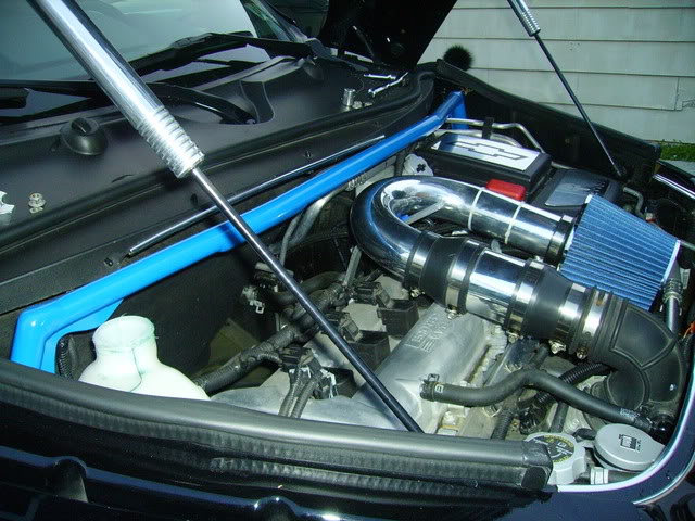

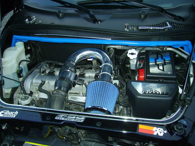

The issue comes more from the stock air box (of an LS or LT anyway) and the way the motor tourques. As you know a front wheel drive car tourques from front to back. I could fit the brace inbetween the stock box and the firewall but when the motor would tourque it would come about 1/2" away from the firewall. Not enough room for a brace to fit without the stock box hitting it so I had to build a custom intake.

So after talking with CJ and everyone at the Tail of the Dragon Cruise and hearing some interest in people wanting a front strut brace like the one I custom fabricated, I talked with my friend Brent who helped me build it.
Looks like we are going to offer a short run of strut tower braces and will start on them the week after Thanksgiving. We will have to buy all the material and build templates for the pieces and build a jig for the brace. We will then test fit every one on my car to make sure it is right.
Looks like we will offer them in primer and you can paint to whatever color you like. I may also paint some up in basic colors I have here now (blue, red, black and silver)(I may have white too).

The strut tower brace will NOT work if you have a stock airbox. The airbox will interfer with being able to bolt the brace in (or visa versa depending how you want to look at it). Will also not work with GMPP, Air Raid or K&N for the same reason. You have to have an aftermarket intake like a CGS, Weapon R or some type of custom fabricated intake.
