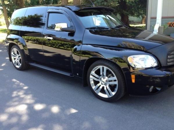

Yep. Dropped the front the next week. Here's the picture with the Pedders all around.
That looks better .

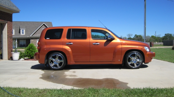

Here is what the Eibachs look like, 2" in the rear 1" in the front, I have mudflaps they dont scrape on speedbumps but they will on a really steep driveway if you dont go in at an angle. They ride really nice due to they are progressive rate springs so they start out soft but stiffen up the further you compress them. Hope that helps.

I am still wondering why you want to drop just the rear. I see your numbers but the amount you say you need just for the rear does not make sense when you look at the stance of one that has been dropped just in the rear vs both front and rear.
Look at Fire's first pic. That is just dropping the rear. Now look at Larry's pic. That is the Eibachs front and rear. Notice when you drop the whole car it sits level with the Eibachs. Their rear is stated as the same amount you say you need to be even with the front. If that is the case then perhaps something is wrong or has been altered already with your suspension.
