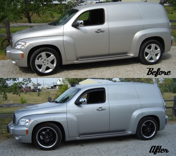

Just depends on how much you want to lower. I got the Goldlines and I'm happy with them. Although I would like to be about 1'' lower.
Here's a good comparison of stock and Goldlines:
(Different wheels, but same tires)
