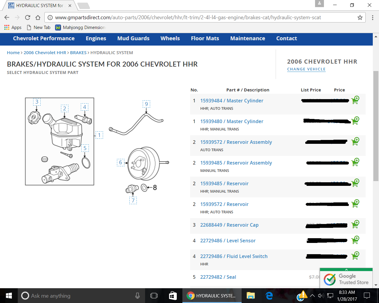

Posts: 11,721
I don't see the info of which transmission this car has. The parts listings show 2 different master cylinders, depending on transmission.
Master cylinder: repair / rebuild kit-screenshot-23-.png
Old Jan 28, 2017 | 09:07 AM
Posts: 40,083
15939480 for the manual transmission, shows discontinued, no longer available
Master Cylinder - GM (15939480)
I do not see any supersede part number , the 15939484 shows for the automatic, without active brake controls ,
Master Cylinder | Genuine GM | 15939484 : GM Parts Direct: Your direct source for Genuine GM Parts
I would consider changing the booster 22713809 also, as they sometimes get brake fluid in them if the master cylinder leaks at the pedal pushrod.
Genuine Chevrolet HHR Brake Booster 22713809 | eBay
