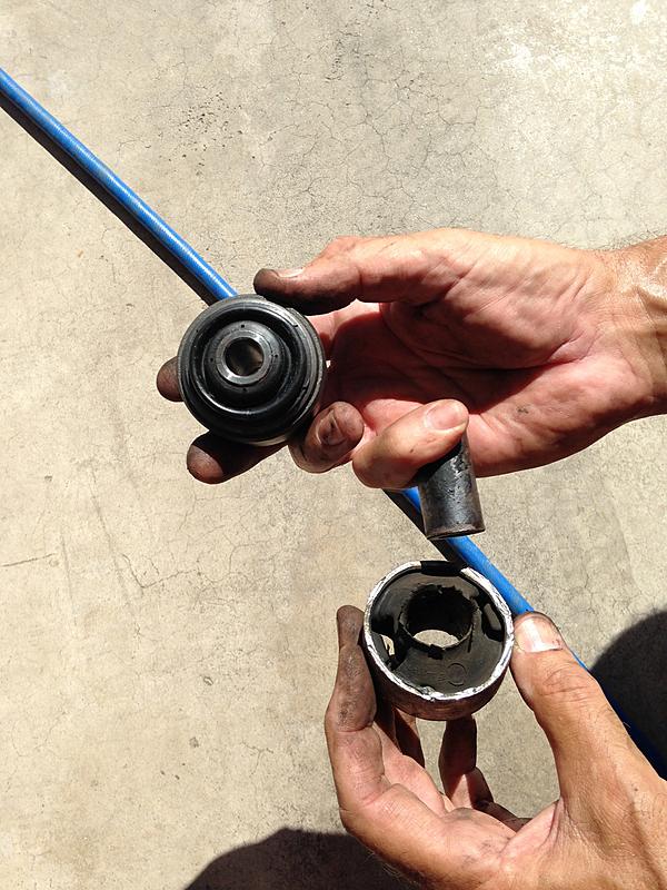

They fit press out the rubber bushing press in the bearing bushing!
I've done this on several HHR's
