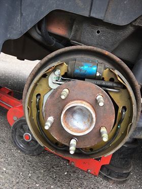

Hi Donbrew,
I´m back with one more question :)
Seller sent me the new one brake drums but those does not fit as well.
Could you help me please choose correct drums?
I attached picture of my rear brakes.
Thank you
