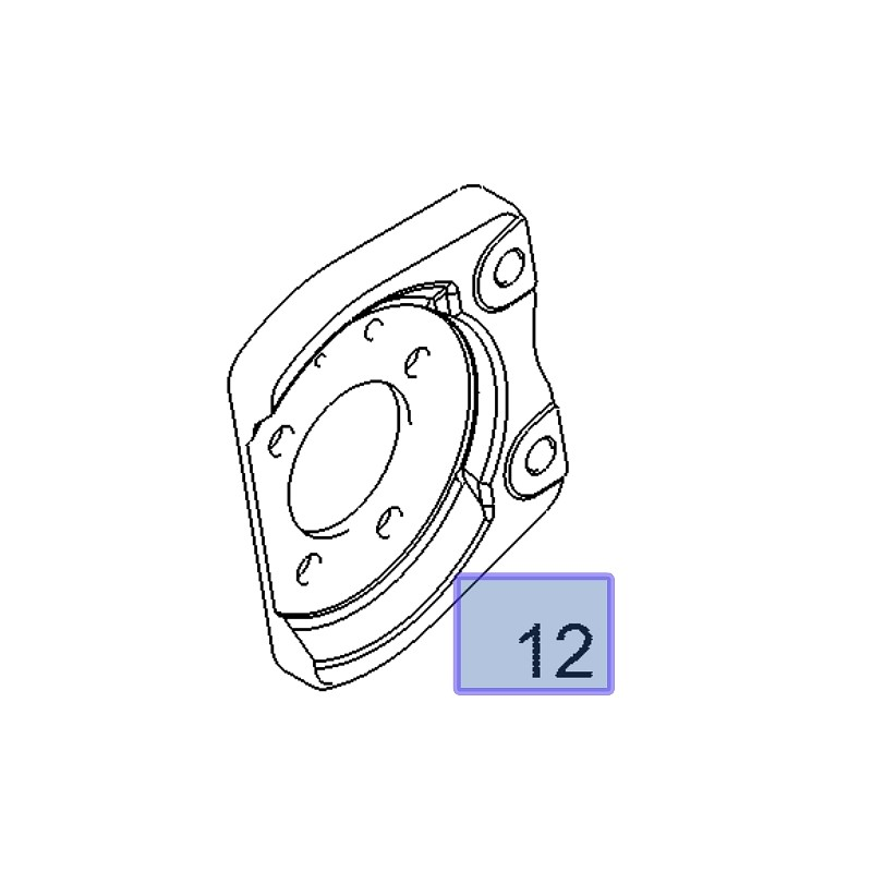

Thats why i mentioned about saturn. Here in Europe bracket it self is easy find and cheap. Part number is GM 13173019 R and GM 13173018 L , but do not know would it work in US ???
for refference got pics unfortunatly not mine
GM europe diagram
Used beam. From what I know it is a bit less wider then hhr one in overall widht
Cherry on top, picture of brackets for 292 mm rotors. link for photo : https://www.courtenaysport.co.uk/Mou...scription=true

If anybody is interested on those factory brackets for disc conversion, i can help with shipping from europe. Calliper it self can be form us market - hhr ss or cobalt ss. All this is for 264mm but it is only a couple of mm offset to do custom bracket (as i did) for 270mm hhr ss rear disc. Beauty of this swap is p&p.
