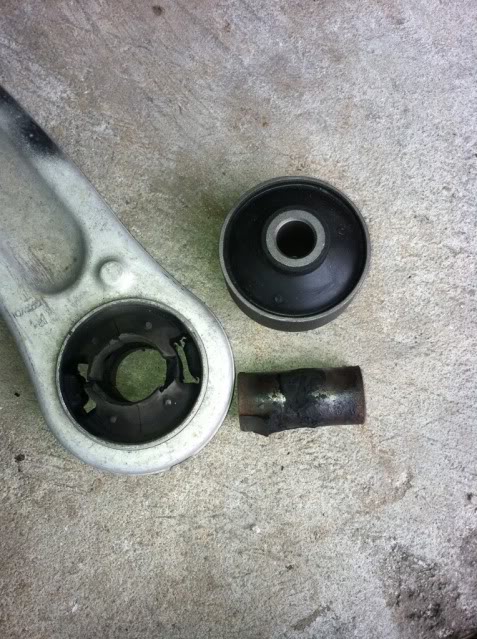

This weekend I replaced the rear bushing on the driver side control arm, along with the hub and the sway bar link.
The bushing was pretty easy to replace, but you need some sort of drift(hollow pipe) to push it out with. The bushing OD is 2.37" so you want the drift to be slightly smaller (I made a 2.30"OD one) so it doesn't get stuck in the control arm bore. The metal ring on the bushing is pretty thin, so the drift can't be too much smaller than the OD of the ring otherwise it will just push out the rubber insert. A piece of pipe with an ID larger than the bushing OD was placed under the control arm to support it and elevate it so the bushing could fit inside of it as it pushes out.
When you press in the new bushing, you still need a spacer under the control arm because the bushing is thicker than the control arm and extends above and below it about 1/8".
Steve
