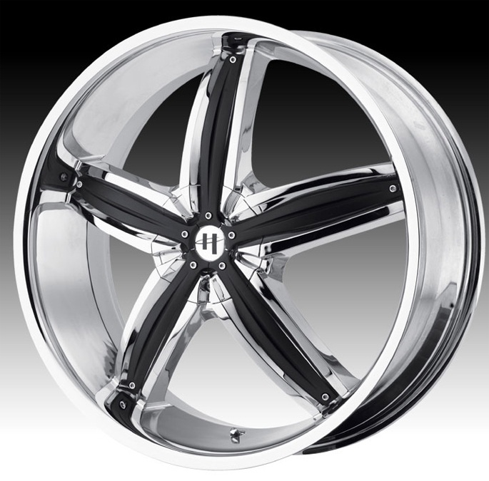

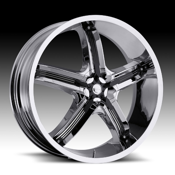

Likely will go with 18" Milanni's or Helo's with 40 offset on 225/45-18 tires, I would like to lower it by just changing springs, how much lower can one go without changing anything else but the springs? I like the way firemangeorges hhr sits and if I can that stance without changing shock/struts I'd be happy.

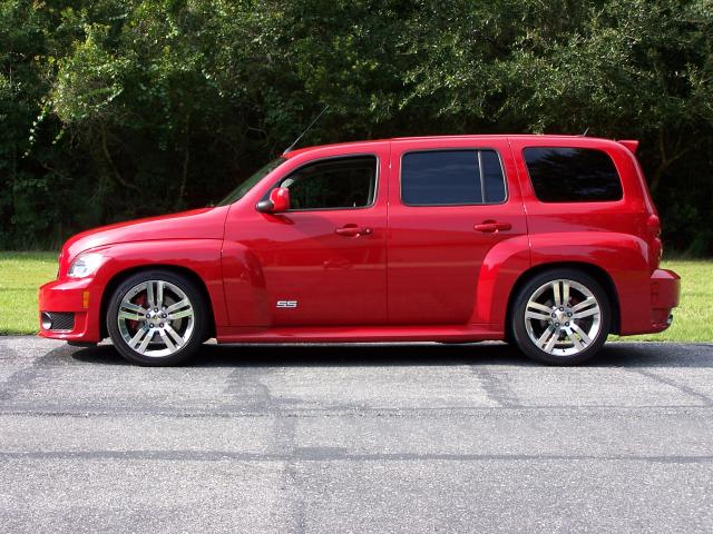

My SS is lowered about 1.5 inches all around. Not sure what you need on a LS to achieve my "look". One of the non SS lowered guys will have to answer that for you.
Attachment 16325
Yes, that is what I'm after stance wise. Now I just need to take delivery of the damn car!!

To achieve that look you'd need aftermarket suspension. I have the FE5 springs with KYB shocks and it sits level at 27.5". Frency42's post gives you a good idea of what the stance would look like.
You might be able to get closer to that look with the Cobalt SS/SC springs, but the are softer than the HHR FE5 springs.
