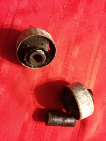

You can replace just the rear bushings in your existing LCA's, however the LCA's do have to be removed and the old bushing pressed out and the new ones pressed in (some have done it with a big vice). The bushings in Canada were $80 each - however in the USA, they range from ~ $10 - $30.
Quickstruts are NOT for an SS..The springs are taller, the SS at factory height are alot shorter then an LS or LT..That alone will knock your front end alignment all to hell. Wrong struts, wrong springs! LCA bushings..common wear item at that age...all depends on where/how you drive(road conditions)so doubt the struts were a major contributor.
