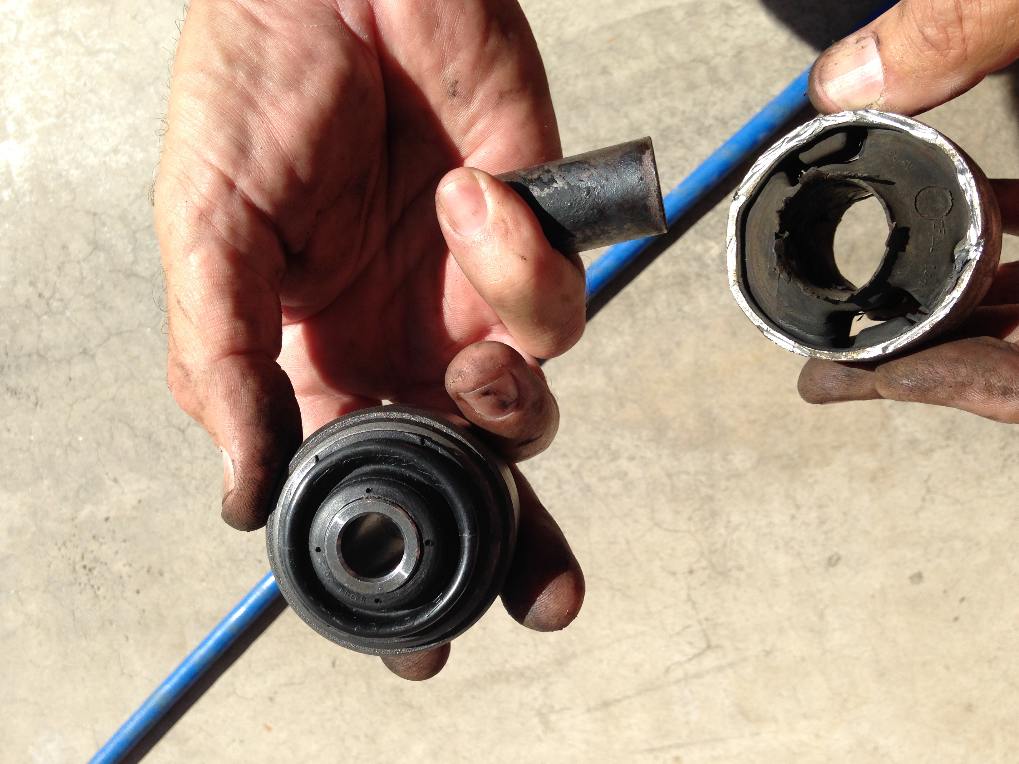

Have a close look a the LCA rear bushings, they can cause a lot of brake shake!
The one on the left is my old 2 piece bushing, it's supposed to by one piece like the Moog Peoblem solver bushing/bearing on the left, part number K200792
They don't list the HHR but it fits the LS/LT FE1 and FE3 suspension
http://www.moogproblemsolver.com/moo...ings_Sheet.pdf
