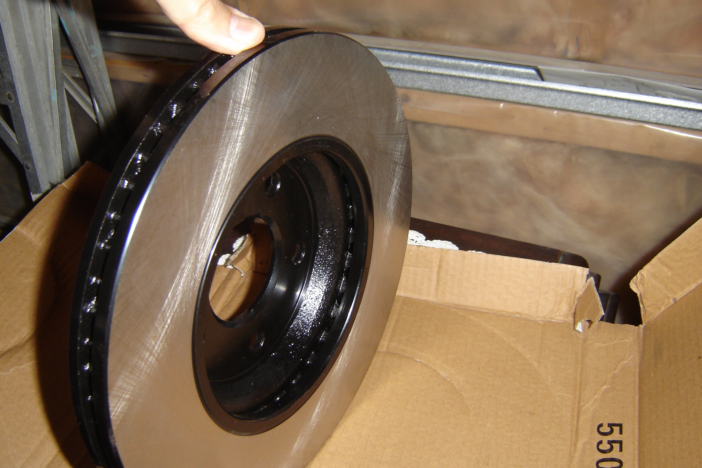

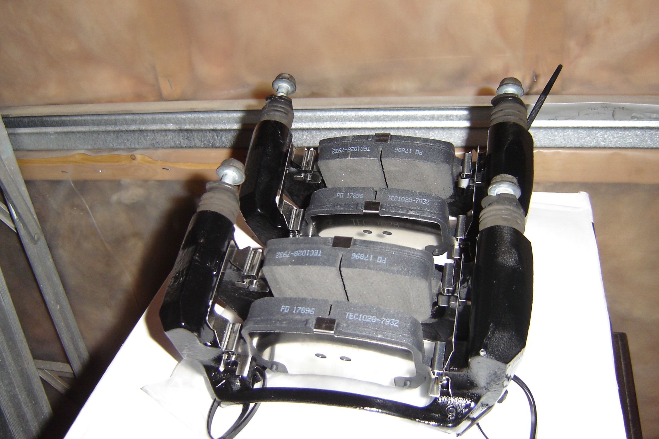

Actually you need the SS non Brembo, rotors and the calliper brackets, the stock brake callipers and pads are the same as your 2LT
Attached Thumbnails SS-front rotors and calipers to an LT2 model?-hhr-ss-brakes-001.jpg   SS-front rotors and calipers to an LT2 model?-hhr-ss-brakes-003.jpg
