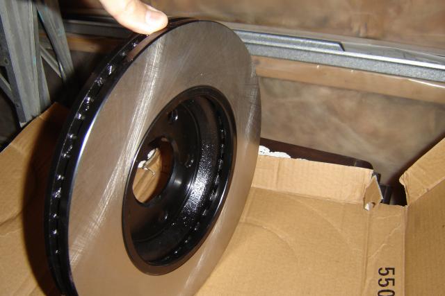

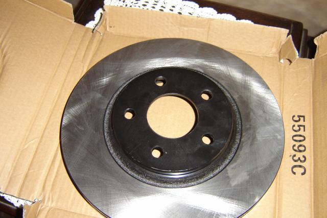

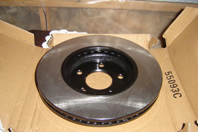

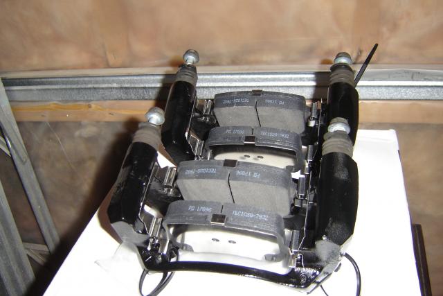

These are the double surfaced machined rotors and ceramic pads from crossdrilledrotors.ca, the caliper brackets are from LT1GMC when he swapped out his SS to Brembo's, all I did was clean them and black powder coat them.
I mounted them up with my stock LS/LT as a test fit to confirm the fit inside my stock 16" 18 hole steelies, and my Wheel Vinitque 16" rally rims.
I just got the brackets back from Powder coat and will be installing these in a day or two.
