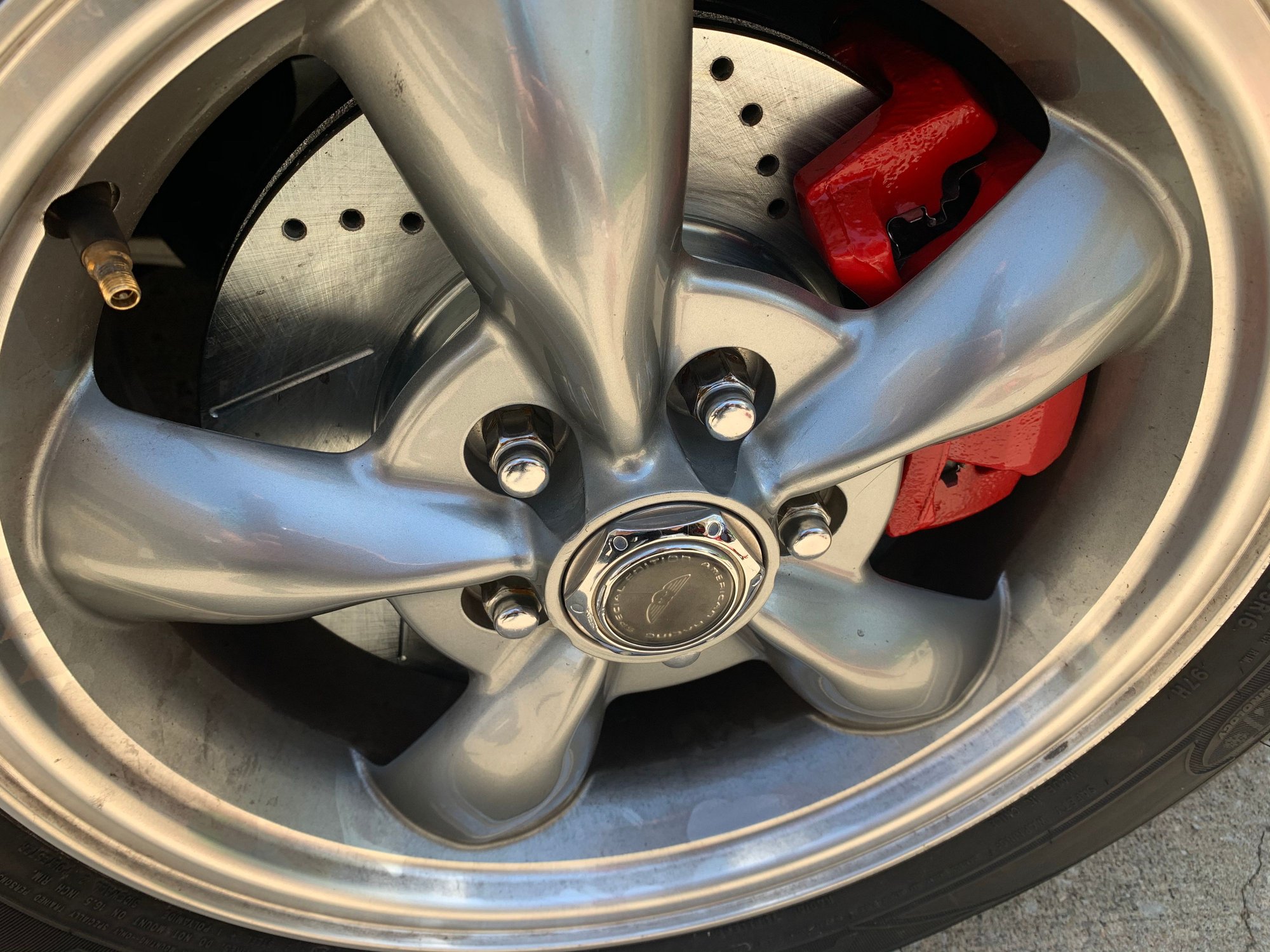

i did the upgrade over the weekend with the Powerstop kit from Rock Auto. I tow a trailer and could use the stronger brakes. My old ones were spongy. I did have to tweak the metal dust shields as they wanted to rub the larger brakes.

chrispacekc- Nice up-grade. If you ever wanna take that to the next level. replace the rubber brake hoses with braided stainless ones.
They do not expand upon hard braking.
PS: Looks great with your sharp mags also.
Old Apr 28, 2020 | 08:14 AM
  #123
Posts: 39,900
Those are a great upgrade, larger rotors, new red powdercoat calipers and caliper brackets! Yes the next step would be the brake hoses .
Cool wheels!

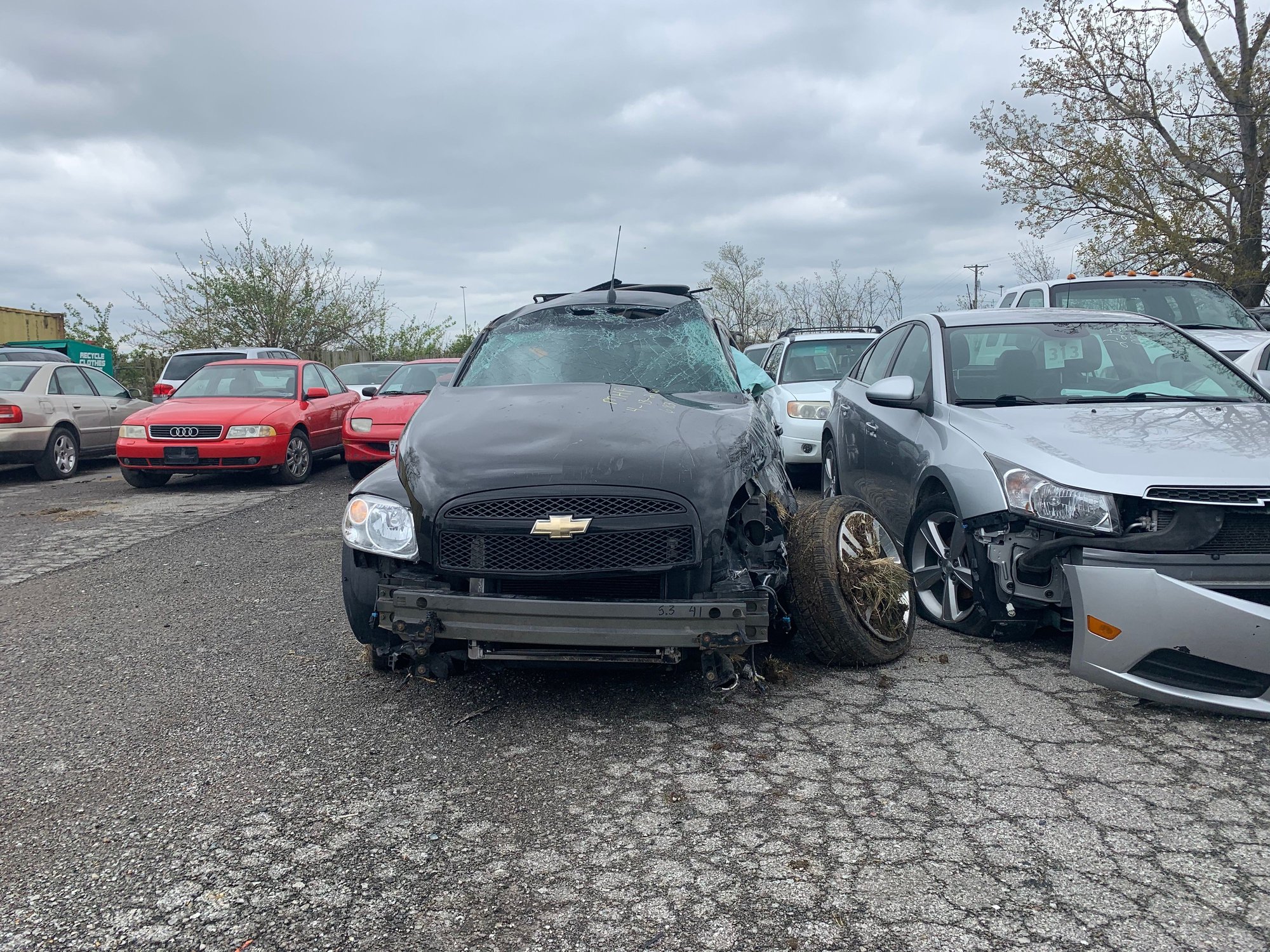

i wrecked my SS 3 weeks ago. So I have a rear axel all ready to go. I may have to do the swap.
Old Apr 30, 2020 | 10:44 AM
  #130
RJ_RS_SS_350's Avatar
Joined: 05-01-2014
Posts: 8,499
From: California
Oh, dam. Are you alright? That looks like a rollover.
