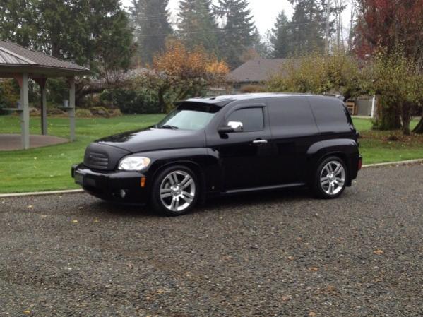

  #47
It's an 08. cleans up pretty good huh ?
Yes it does.....
