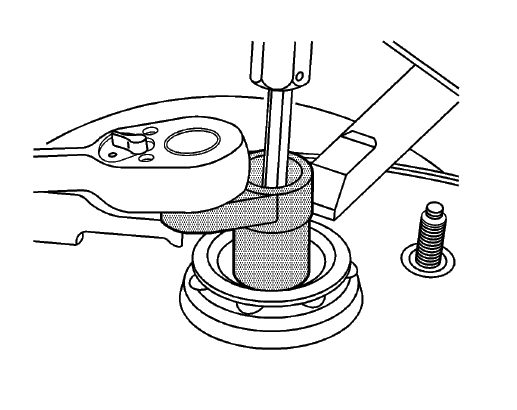

I'm replacing the struts on my son's 2008 SS.
I did this before on a few 1LT HHRs but can't remember what I did.
How do you tighten the nut at the end of the strut shaft? It's a 21mm nut with a T-45 Torx in the end of the shaft to hold it.
The nut is down deep into a recess in the strut mount so you can't put a wrench on it.
I am thinking a deep 21mm socket held with vise grips while using a long T-45 torx wrench sticking up out of the socket hole.
Is there some special tool for this? A sharply 90 degree offset box wrench?
Steve

I tightened those nuts after I put the cars weight on the suspension, used my 21 mm deep socket and torque wrench.

Air impact gun. They make a tool that is a 21mm socket with a hole in the top for a torx to go down. spanner plus torx.

If my memory is working, it’s a 6 mm Allen wrench and that thru socket wrench

This is what I ended up doing:
I had a 21mm deep-offset box wrench which fit into the recess in the strut mount.
Yes, the wrench is cut off halfway down the handle (there was a 23mm at the other end) because I needed it to fit into a short space for the 21mm engine cradle nut.
It worked pretty well this way.
