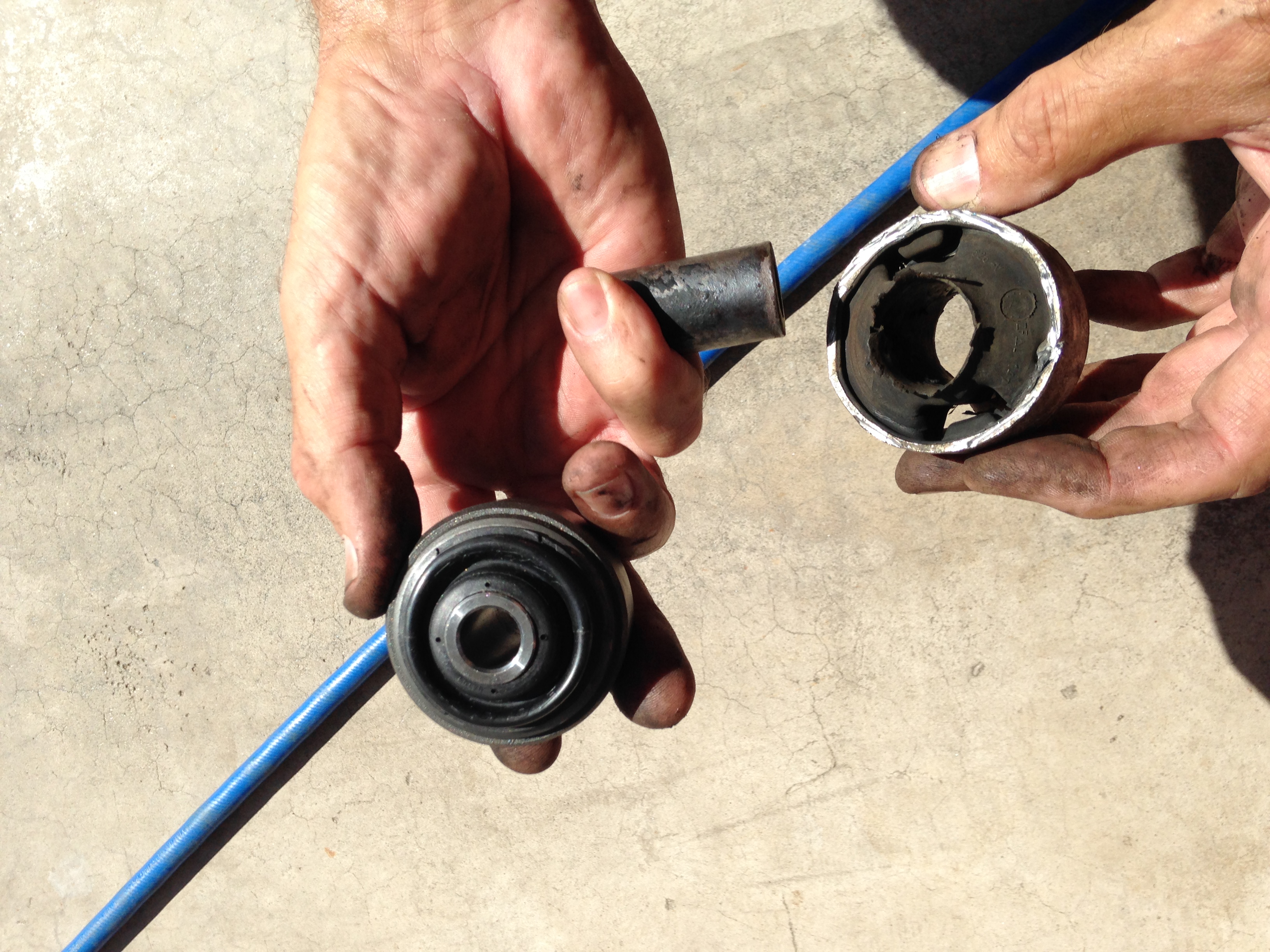

The LCA bushings deteriorated, this is them on the right, the new part is Moog K200792 problem solver
Yeah they do make upgraded parts now that will last longer than oem.The spherical type control arm bushings and delrin or poly sleeve bushings last much longer.
The original parts are soft rubber that can deteriorate in a couple years.

I replaced pretty much everything on the front end of my HHR. Most of the stuff really did not look to be worn that badly and I still had noise. Finally I replaced the bushings in the lower control arm, even though they did not look to be worn very much, and the noise went away.
I am convinced that most of the stuff really did not need to be replaced and that if I had started with those bushings I would have saved a lot of money.
I went with the Moog problem solver bushings on both cars.
I pretty much did the same on my PT Cruiser GT convertible. Again the last thing I replaced was the bushings in the lower control arm to finally get the noise to stop.
