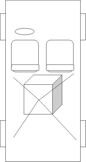

maximum load = 401 kg = 880 lbs.
Put the flat rear seat backs. Get a big loading platform.
Lap resulting space thick plywood. But it would be better to use a wooden pallet.
Wooden pallet does not bend under the influence of body weight. Heavy object can be easily mounted to a wooden pallet by the ropes. Wooden pallets can be found in the courtyard of a grocery store - pallets used for transporting packages and then discarded.
There should be no load close to the rear bumper. Place the load close to the front seats in the geometric center of the car.
Fix necessarily your weight. When braking at 40 km / h Bible acquires the properties of 25 kg shells and broken bones. In similar conditions of 200 kg. piece of metal can turn a man to mince.
