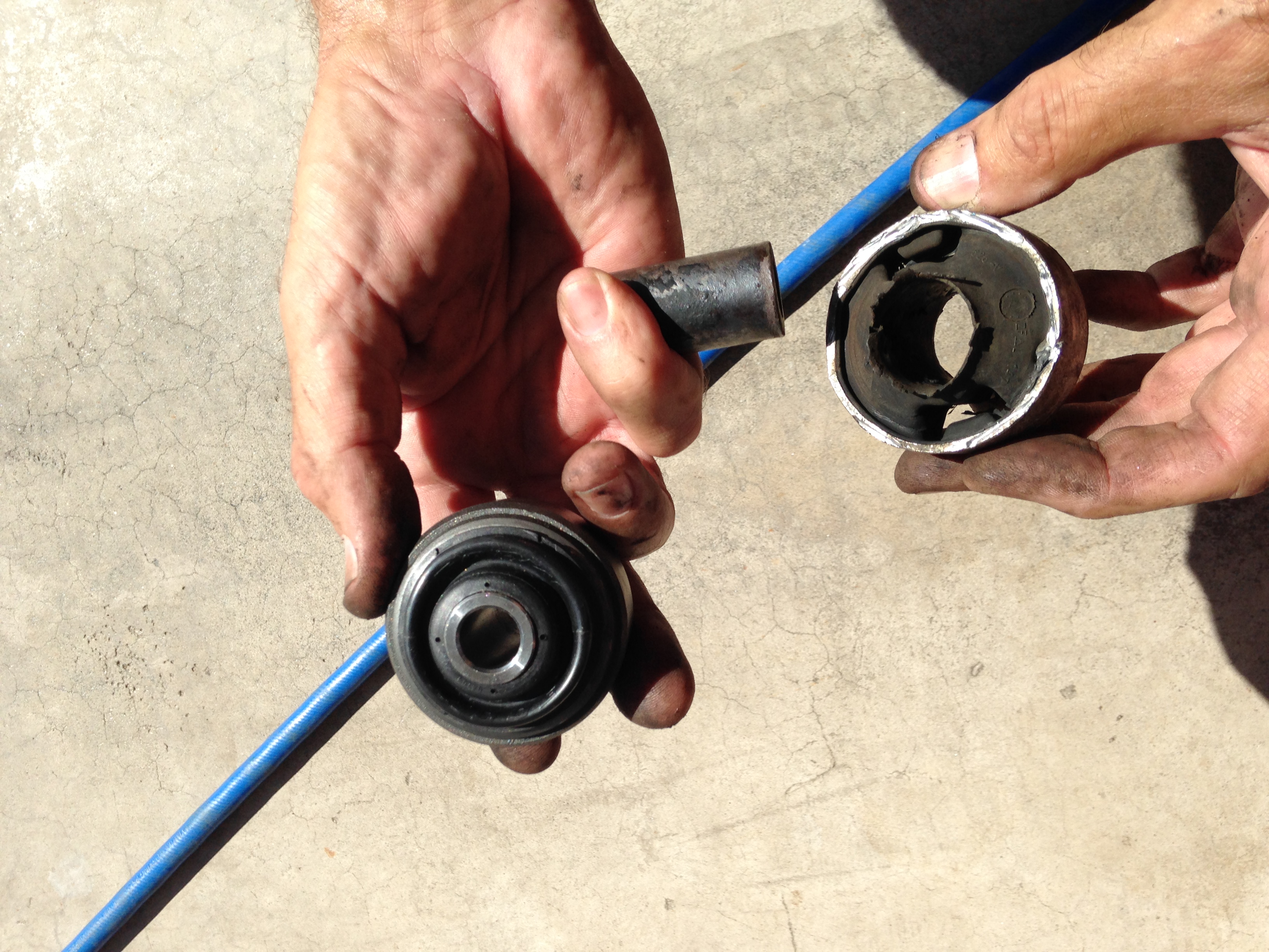

My clunk turned out to be the rear LCA bushings, at that time I pressed in new GM rubber bushings, but back to the swaybar!

Posts: 39,986
BDR1973, so did my bushings on the LCA, when I removed the LCA they fell apart that's the OEM on the right and a Moog problem solver K200792 on the left
