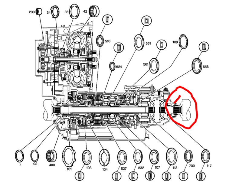

See post #5 in this thread https://www.chevyhhr.net/forums/driv...acement-57024/
That bushing is the only thing and it is basically just something for the rubber seal to ride on, it would leak. You had to remove the stub and replace it when you replaced the axle.
But, I still don't know how you came to diagnose a "humming" noise as the axle. Or how you determined the hub is "fine".

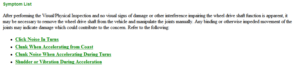

This is a list of symptoms for diagnosing a bad CV axle.
