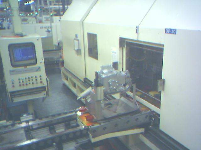

Here's one of the 12 Test Stands that were in Windsor for the 4T40E. It filled the dry trans, tested it, then sent it off to Button-Up to be sealed, topped up and racked.
Different models went to Lordstown OH for the Cobalts, & G5's... Lansing MI for Aleros and Malibus or Ramos Arizipe MX for HHR).
They were "fully" automated, with 3 computers in each.
Sorry I didn't have a picture of the Button-Up filling station.
