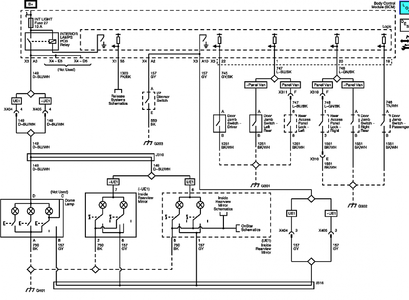

I have an 08 HHR and the dome light switch was broken when got it and the digital on the rear view didn't work. I replaced the dome light completely but still neither work. All fuses good. Any other ideas to try

It is a relay that keeps the power on for a few minutes after you remove the key; RetainedAccessoryPower.
And as an after thought; is the dimmer turned all the way up?
Attached Thumbnails Dome light and rear view mirror not working-int-lights.png

Look at the diagram I just added. I am guessing the the dimmer switch on the dashboard either got turned all the way left or is broken.

I have no idea what that "PCB relay" is.
Believe it or not; there are some DTC Bxxxx codes related to the dimmer and the interior lights. You would need an expensive Scanner to read body codes though, the over the counter kind usually won't read them.

The relevant ground is G401 left rear near the backup lamp.
