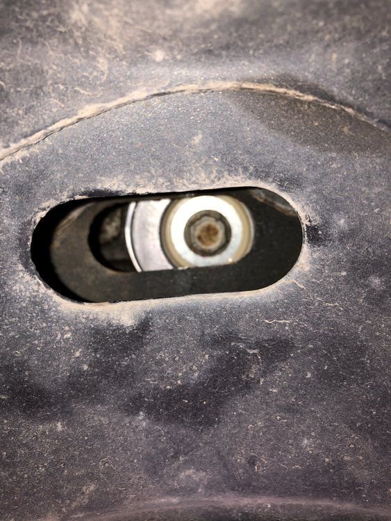

The bolt for the serpentine belt tensioner should be in the middle of the slotted hole inside the passenger side front wheel well. If it’s low in the hole, the engine mount is toast!

I thought that since I had a exhaust noise right after the noises started that the tensioner bolt location suggestion was going to be it but it’s centered.... all the mounts appear good.. no noticeable cracks or deterioration... I guess I’ll have to get it to the local garage for them to check the mounts better on a lift... thanks for the replies
