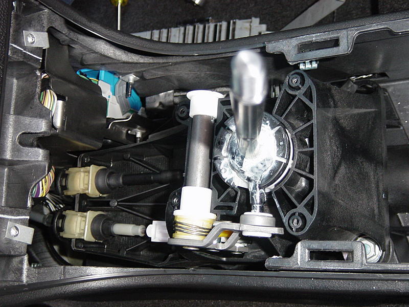

Hopefully it's not serious or costly. As Don suggested, take a look at the linkage. May be something simple like one of the cables is loose or isn't clamped down good in the holder/connector.
Dug up this old pic from yesteryear. Shows where the cables should be clamped firmly in the bracket.

I was playing around with second gear today and noticed something. If the car was decelerating and I downshifted into second, it stays in gear and you get the normal engine braking. The second you touch the accelerator pedal, it pops out, even if I am holding the shift lever against the stop in second.
So it seems the gear itself is ok. Whatever mechanism that keeps it in gear under acceleration is what is causing the problem.
I checked the underhood end of the shift cables. They looked OK. I will take the console apart so I can see the other end of the shift cables.
Steve

Posts: 26,448
In other words: the shifter linkage.
