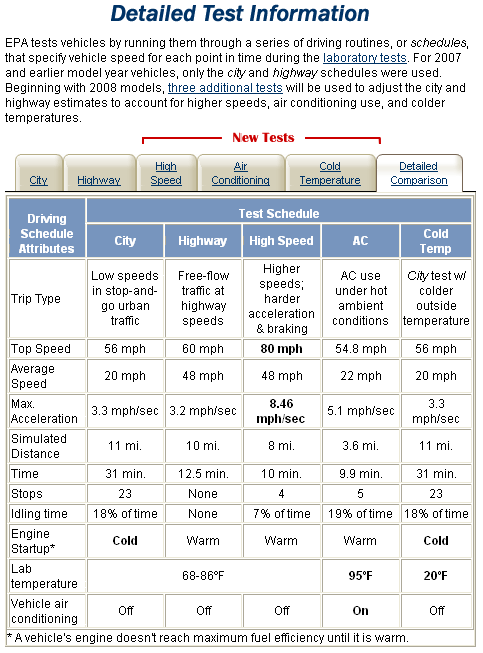

Originally Posted by nfboy
Average speed still means nothing with respect to MPG.
I think we can all agree that average MPH is not part of the equation for MPG. No one is arguing this.
I thought this thread was to talk about how everyone else was doing with the fuel economy of their HHR. Do we need to go back to the very first post? I think my point of observing average MPH will give you a clue on why one person would get 15 MPG while someone else getting 20 MPG with CITY driving. Better yet, why are we not getting the MPG of CITY that is on our window sticker?
It seems like some one at EPA has an interest with Average Speed.
