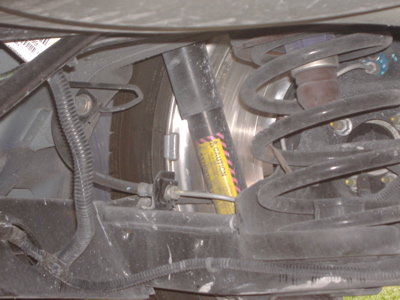

2LT has a larger front anti-sway bar, and had gas shocks.

It is going to be a used purchase. Could someone take a picture of theirs shocks, one for 2LT and one for 1LT please and post them in this thread? The VIN just tells the difference between the LS and LT, not 1LT and 2LT.

Is this what your looking for? This is a pic of the rear shock of my 2 LT........
