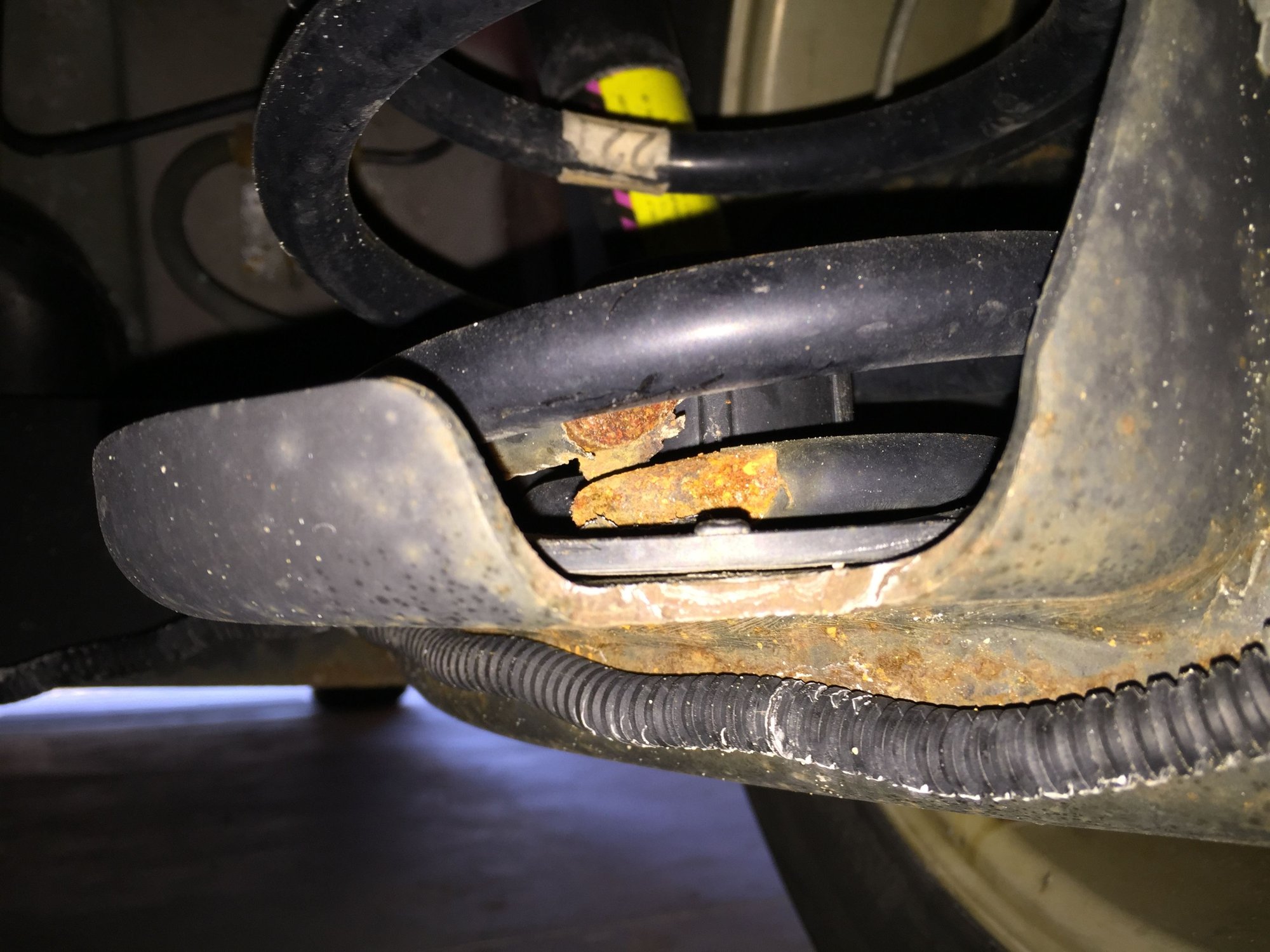

Rear spring broken?

Rear spring broken?
Rear spings are new, shocks are old
