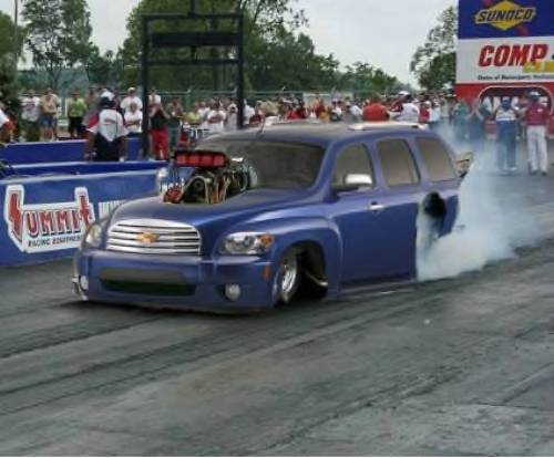

Not quite what you requested, just the same it could be inspiration.

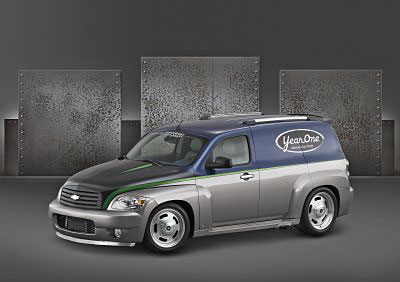

Year Ones' V8 panel from the build-off in 2005
2nd pics just makes me smile..
Even if you found a frame, say from a jeep or shortened S-10.. To hide the frame rails, you would need to intensely channel the hhr body to hide them..
There have been many members come on & have this plan, haven't seen anyone do it tho..

I think you guys missed the hardest part. There is no tunnel on the hhr to accommodate the driveshaft,, and no room for a differential to sit.
year one, foose, mothers, and craftsman all built v8 powered panel clones. For a speed channel build off in 06. None of them were able to be titled because of the major corners they cut, during the two week build. They all chewed up the mono frames, without reinforcing what they cut. I bet after a few wot, the frames started to deform.
