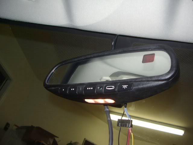

I put in a Homelink autodimming mirror. The one out of the Chrylser Sebring works with dimming map light. The compass/temp is red but you can take it apart and put a GM teal lens in to match cluster.
Test out....
