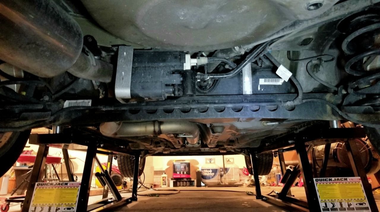

QuickJack with SUV Lift Blocks...
Provides ample room between Lift Frame and Car chassis.

Nice , is it in the way to drop the fuel tank if you need to change the intank fuel pump?

It may be in that position, but it can be used vertically (cross ways) too.... but don't know. I'd say no more than a dual posts arms? I'll look tonight, but from my memory... I thought the tank was open to drop. I'm on pinch seams, with it going up even on all points... pinch seam didn't bother me. But as all lifts, none fit all occasions.

It looks like it would clear, have you considered pinch seam pucks to protect it from flattening.
A groove in a hockey puck or HF has them

I use a short 2" x 4" board that I cut the groove cross-wise on the grain. Been working fine for many years.

They make pinch blocks of 2 heights and the SUV blocks have a small channel... but interestingly, it does well lifting straight up.
If wasn't pursuing the fuel lines, would have slid in further to other mount points.
On the question of dropping fuel tank. As it's positioned on pinch seams... plenty of room to drop tank. Easily clears on both sides.

The pinch groove in that puck looks a little shallow for the seams. I'd guess the seams are about 1/4-1/2" longer.
The JQ blocks have multiple seam grooves on each side of about twice the depth of example puck.
I ordered, but still waiting to arrive.

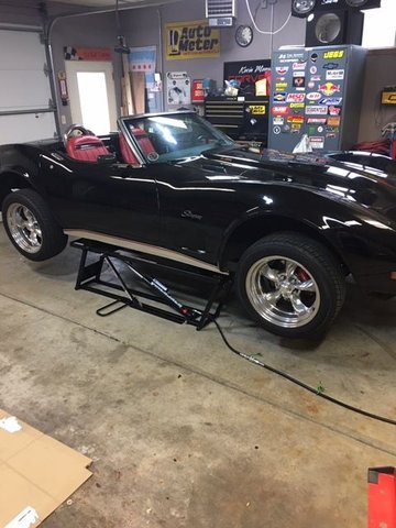

Love this thing. had my vette up on it yesterday adjust 4spd linkage
