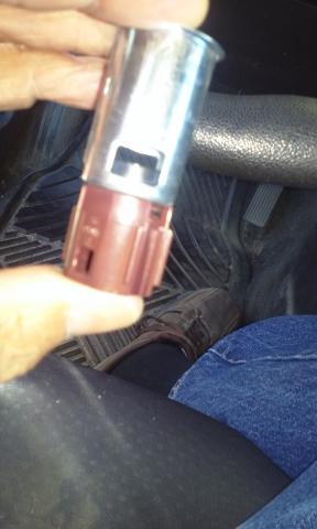

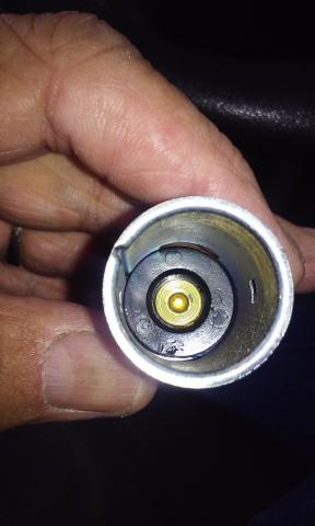

These are pics of a "12 V accessory outlet". Not that if you tried a lighter in it the "Fahrenheit 451" part would make contact with Plastic. This would cause at least melting.
I would advise inspecting the receptacle before trying a lighter! All HHRs have 2 "accessory outlets", some have 1 cig lighter in the front instead. Maybe somebody has replaced the outlets, though. Hint: if it has a rubber cover attached to the bezel, it is an accessory outlet.
