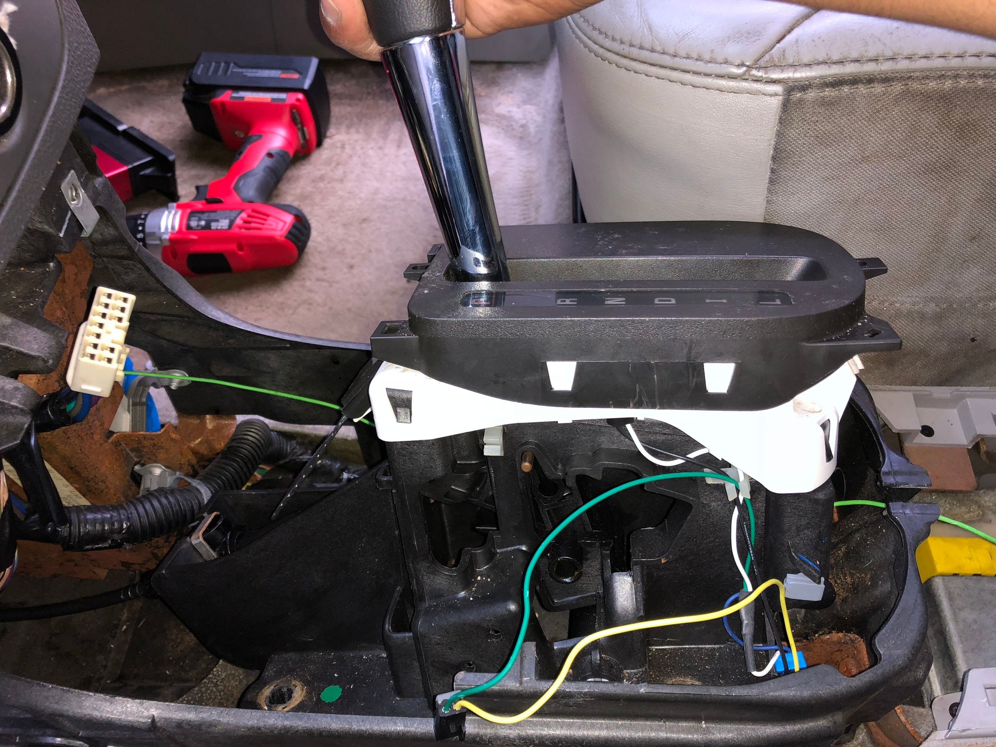

this his is what I got so far one of the pieces is missing
The micro switch has disappeared! It should be attached to those 2 wires.
New assemblies used to be on eBay for around $100. All years work.
like this among others.
https://www.ebay.com/itm/GM-OEM-Cent...kAAOSwXXxZQ4r1
If you want a used one send a PM to hellshotrod, he has several HHRs he needs to liquidate quickly.
Does anyone know if there are part #s for these 2 pieces that I circled in the picture because they are missing in my assembly and I want to at least replace them before I even attempt to call Chevy to see if my assembly is under the warranty I don’t want them giving me an excuse they can’t because of a missing component.
There are no part numbers, as I said earlier they are non-serviceable. Brand new assemblies are $65, used cheaper. Now that you have done all the labor yourself it really isn't worth putting it back together, is it?
