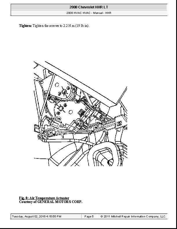

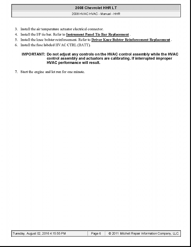

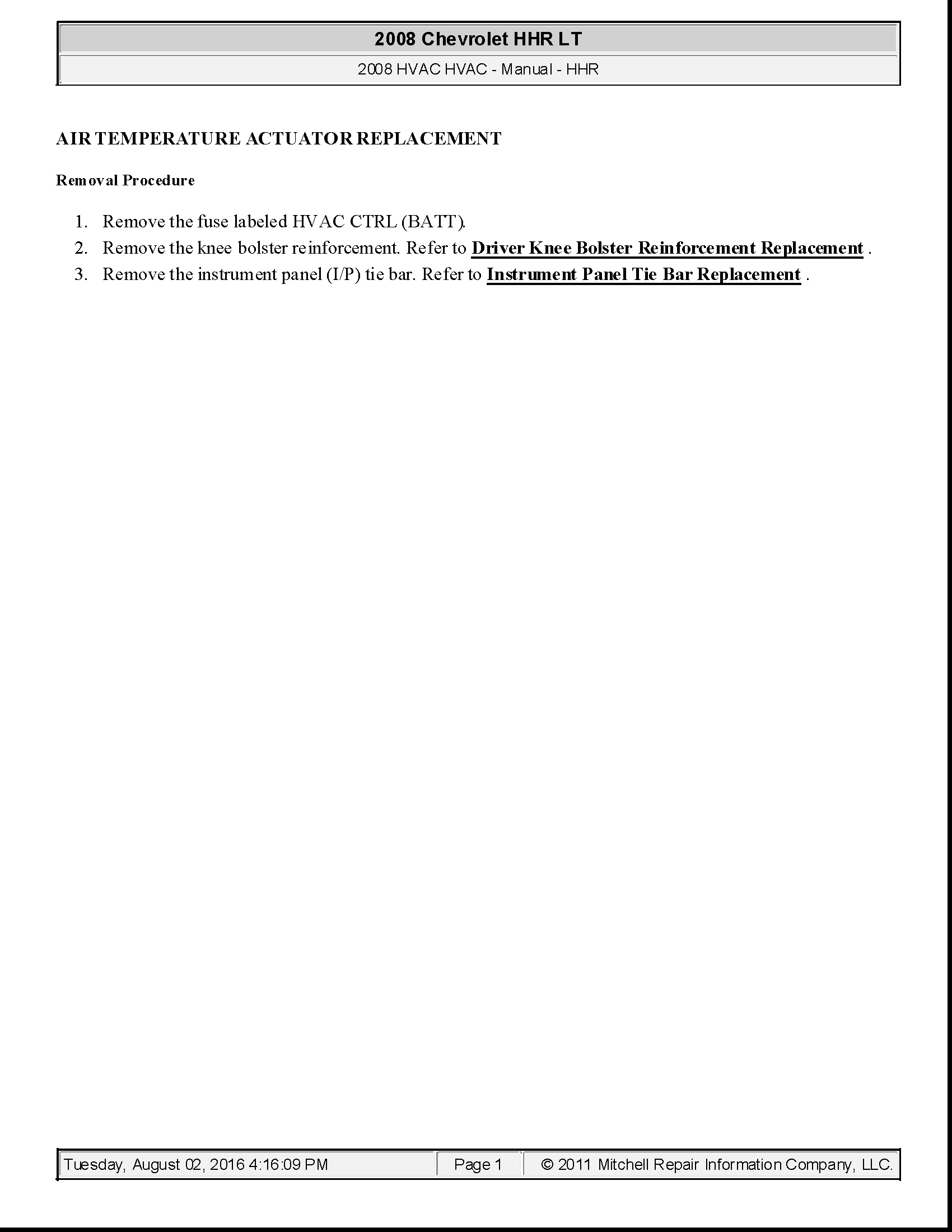

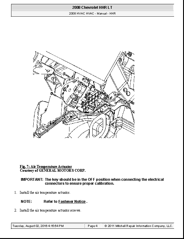

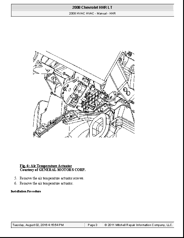

Is this what you mean? Read the printed page numbers not the order they appear in.
Attached Thumbnails blend door actuator-hvac_page_1.png   blend door actuator-hvac_page_6.png
