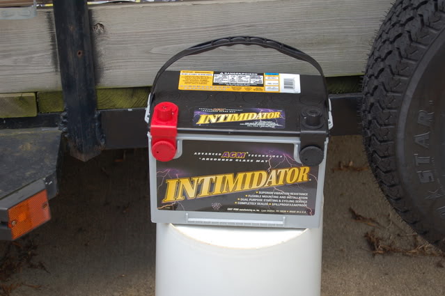

Well I went to CarQuest this morning, but even in the place with them looking on their computers don't have much in the info department.
None in stock but can get from the warehouse twice daily.
Got the info that I could get, and someone I talk to on the Cobalt forums who knows car audio pretty well mentioned the Deka Intiminator AGM battery for comparison as it gave some specs.
Turns out this Deka battery has Better cold cranking amps specs and a better warranty.
I looked them up and found a warehouse type location about 9 miles from me and gave them a call.
It was a little less than the carquest one as well.
Gonna try it out for a week or two, then if needed I will get a second one and run dual batteries.
http://www.dekabatteries.com/assets/base/1143.pdf

Deka batteries>
Make sure it is a AGM not a jell cell, you dont want a jell cell, I did not know that Deka made a AGM battery.
