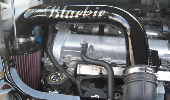

whats a cai ?????
Old Jul 20, 2008 | 11:12 PM
afs9's Avatar
Joined: 09-14-2007
Posts: 3,365
From: SoCAL & Louisville, KY
Originally Posted by Budro
whats a cai ?????
Cold Air Intake
or
This :
