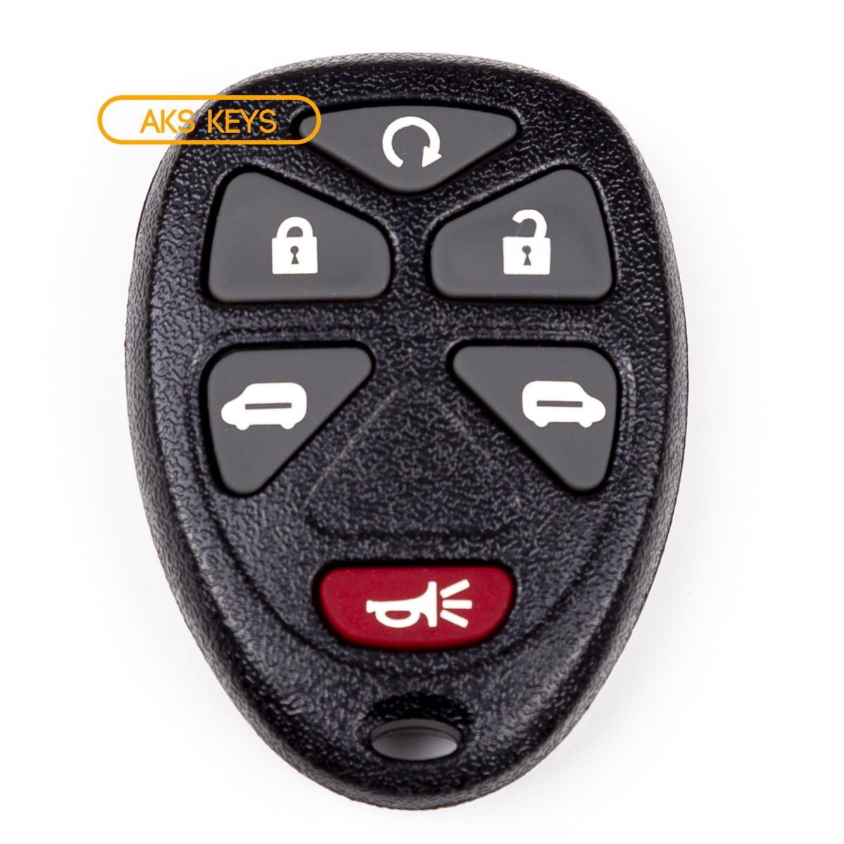

Yours should have 6 buttons , similar to this

Strange thing is, it has door popper buttons, but no remote start

Then you got the wrong fob or possibly your hhr doesn’t have rvs

That's a fob for a panel HHR with 5 speed trans. No remote start with a standard shift.
