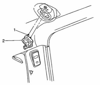

Possible Solution
There are (IMO) 2 logical places to add reinforced clothing hooks. Which you prefer may depend on which model HHR you have and/or personal taste. I assume you have a non-Panel HHR, though your passenger needs may not bias one method over the other.
The attached diagram shows the coat hook(2). While the hook itself is doesn't appear too sturdy, the attachment screw(1) is more so. You might consider removing the coat-hook and using the screw to attach a d-ring that can support the weight of a clothing bar might work for you. Note that this screw is only torques to 80 in lb. Aside from the torque the drawback is that the bar will be centered on the door opening.
On the b-pillar just rear and a little lower than the coat-hook is the attachment point for the upper seatbelt retainer. The bolt holding that upper retainer has a torque of 32 ft lbs. and is centered over the seat back, which will make it a little stronger for the weight of everything you need to carry.
As suggested by others the small size of the HHR compared to a full size car means you may need to shorten any clothing bar you find. Ace Hardware offers a Custom Accessories Adjustable Clothes Bar (56663) and Amazon.com offers a Highland 9142200 Clothes Hanger Bar for under $15 either of which should do the trick. For d-rings you should be able to find the type with rolled-over attachment tab for cheap at either a hardware store or your local leather store. These are usually available in stainless steel.
With a little care either of these methods would solve your problem and look like a hack job in your otherwise nice car.
