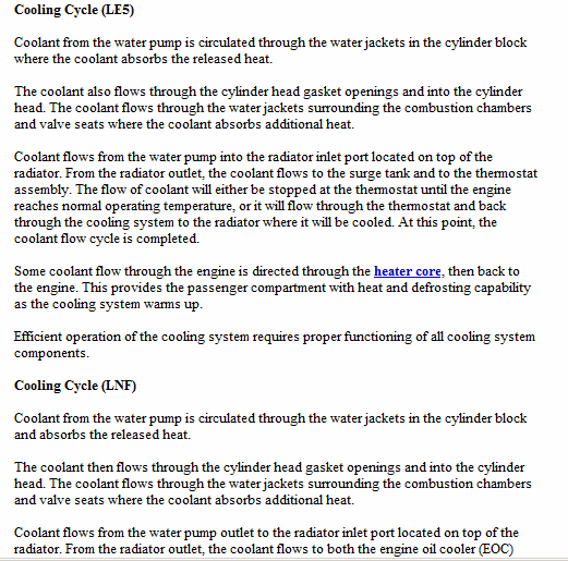

Here is what AllData says:

All data says B, we can't argue with that! Maybe it's gravity because I do keep the nose up while filling the system. That would make sense I suppose. I still think we should be able to tell by rotation and the impeller design.

And the tube goes to the center of the impeller. Wouldn't centripedal forces want to throw the flow outward? So, t-stat to pump.
