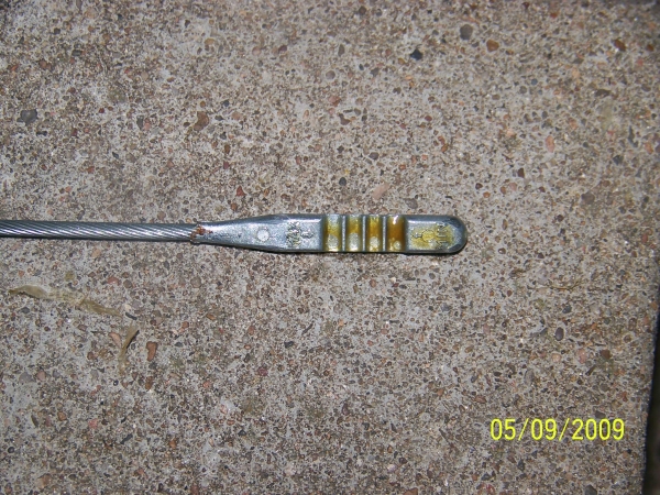

Does this look like water mixed with oil on my dipstick??
Would anyone know if this picture looks like there is oil and water mixed? Could someone post a picture of what it is supose to look like? The reason I am wondering is because after I picked up my hhr after a month of it being at the dealer it overheated again. This time I took a picture of the dipstick because they keep telling me that no water and oil has mixed... which I find it very hard to believe... anyways.... I know that they are in the process of geting ready to change my hhr with a new one since it has overheated for the 7th time but as we speak GM's attorney is fighting with my attorney over legal costs that has added up... basicly GM doesnt want to pay the attorneys fee's but they really dont have a choice. The oil does look milky to me but Ive never really paid attention on how it supose to look. Anyways the dealer just called, they informed me that the head didnt warp like the last 2 times but it was a cracked head gasket, which has only been on the car for less than 100 miles... go figaure... sounds like a installation goof up to me.

Most times when I have had blown engines it looks like a tan milk shake. But these were rtace engines with dropped valves.
Also look under your fill cap as moisture will collect on the under side of it.

Kinda sorta, not enough oil on the stick to tell.
the dealer informed me that I had lost alot of oil, it was leaking out of the side of the block/head on the drivers side.
