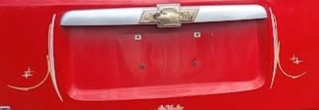

Worst part? They used a DA sander to remove some of the hand painted company logo. Went through to bare metal in a couple spots.

But I would get rid of this pornography on the gate

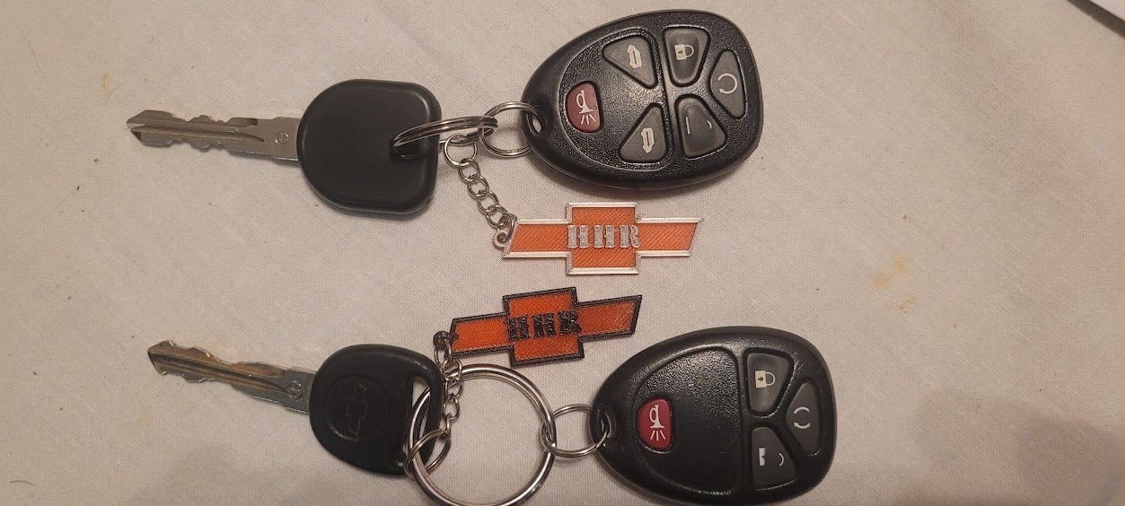

I already replaced the broken door handle and the MAF sensor with parts from the junkyard. Now the code is for low voltage on the MAF, which usually indicates a plugged air filter. Got a new air filter and cabin filter to install. I cut a quarter panel patch from a junkyard HHR, and I can bump out the door dent pretty easy. It has 3 new tires and one mismatch, seller told me a pothole took out one wheel and they just grabbed a replacement from the junkyard. I'll worry about that later. Got some cheap hubcaps, good enough for now. The remote fob isn't working right, all that works is the panic button. Lock/Unlock and remote start are not working, I know a CEL stops the remote start function, but not sure why lock/unlock doesn't work. )& didn't have door poppers on the remote, but the dash buttons work fine.
My 08 is all chromed out, I'm going blackout/body color on the 07. I plan to paint the center stack interior trim and door trim red, and blackout the grille and headlights, and other exterior trim. First step was making the keychains LOL

Clean the contacts inside the fobs, and put in a new CR2032 battery and check the battery cage for cracks or damage
