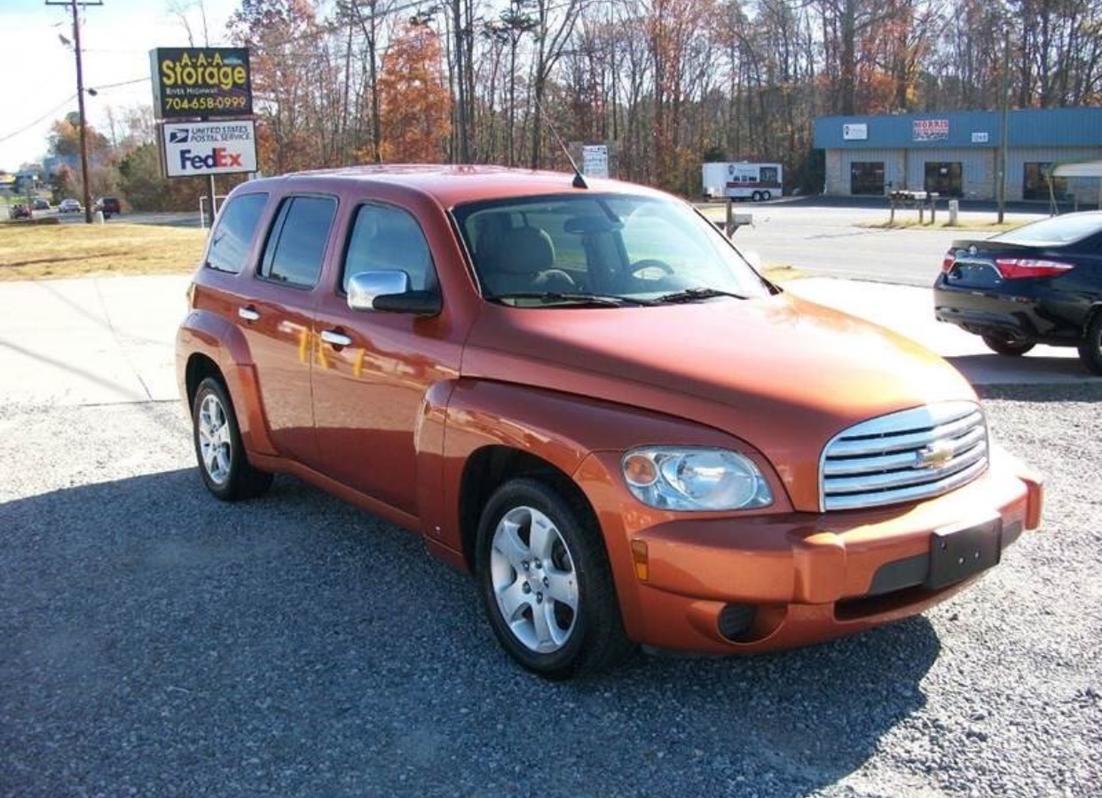

Hi everyone my name is Jase and I'm from North Carolina. My wife and I have a PT Cruiser (no boos or hissing) and looking to add to our family of cars and I really want an HHR. Been on Autotrader, Cars.com, CarsforSale, Carfax, and a few others. Anyway I found an excellent deal on a 2006 HHR LS with 120k miles - clean CarFax and no accidents. Inside and out the car is sharp as a tack. Since you all own a HHR already - is there anything I should be looking out for or keeping an eye out for? Taking on a test drive this Friday and would be looking to purchase then too if all goes well.
Thanks in advance and take care - Jase

The OP's shown car is a LS, so it will have the 2.2. If I remember correctly, the 2.2's that year didn't have actuator solenoids.
Those 2.2's were only used that 1st year of the HHR so they are kind of "unique" in that aspect. The years following got the newer versions of the 2.2.
The 06's also had that butyl patch issue that could lead to water leaking into the cabin area. If that was never addressed, chances are that the passenger floor interior has been flooded before. Check the carpet for any dampness or evidence of previous water stains. Those leaks could also cause problems with the blower motor and it's resistor.
If you're looking to own an HHR for a long period, I would suggest maybe a newer model with fewer miles.
