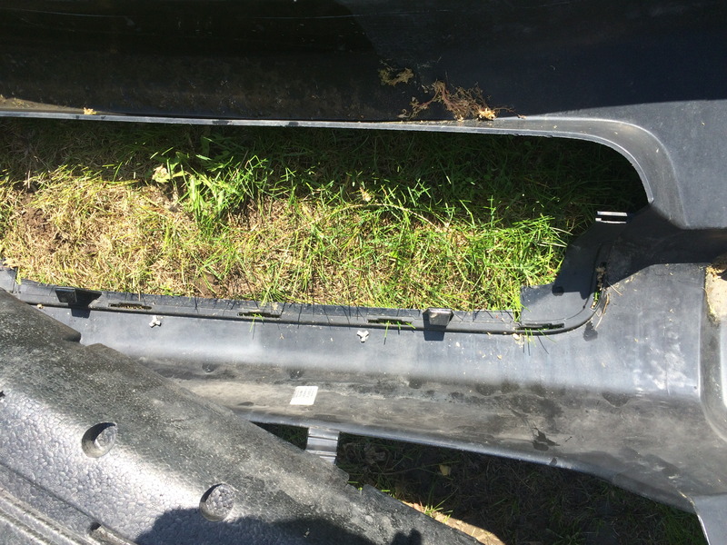

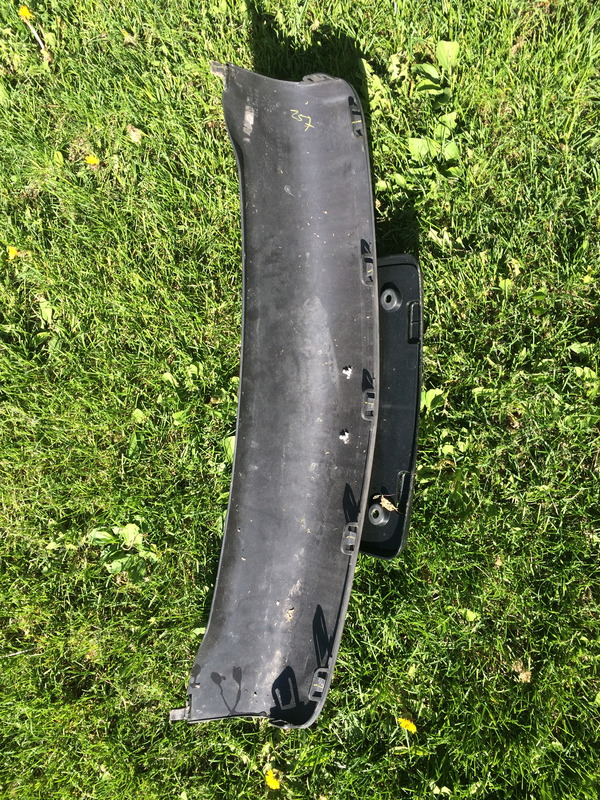

Here are pics of the other side, the bumper cover will need to come off, because the impact foam will be in the way to get at the 7 tabs.
Grill

Bumper cover with foam moved for viewing, the tabs go in the slots.
